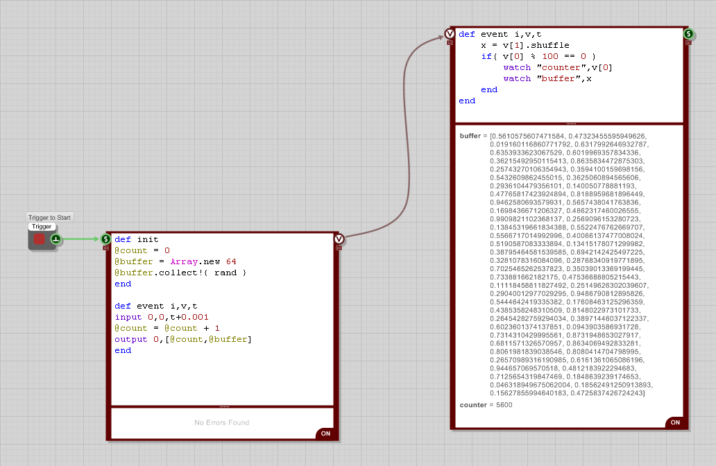

In this example we test the communications speed between two Ruby Modules.
This example uses a frame of 64 samples sent between two ruby modules at 1Khz. Therefore the data rate (which is by no means maximum) is around 64Khz!
The max data rates can be several Mega Hertz!
hi speed (buffer) clip.png (86.42 KiB) Viewed 22674 times
