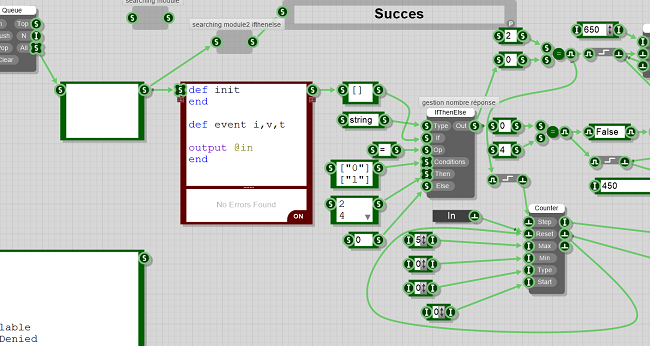

Postby RZK » Tue Jun 03, 2014 2:46 pm
Hi everyone, One more think, i have a response code "0" from my machine when the command sent is succesfull but when i use a IfThenElse module, the "0" is like nothing(empty case). then i can't compare the response incomming from com port to send another line. Or it send a new command always enven if i don't have 0 incomming trough the com port. it make me mad ><. i try on 3 differents types on the ifthenelse (float int and string, its do the same.)
Thank's for your help guys !

Postby RZK » Tue Jun 10, 2014 8:34 am
it's good i use a in out in ruby code to have "[]" at output and i compare with a if then else to a empty [] or with 0 and 1. i have delay to wait response from my machine to my pc when i send a string, but i can't stop the flow of my send even if i don't have response trough the com port.i use a other flowstone program to simulate my machine and a port com simulator to communicate with the 2 programs. the first programm send a string and the second programm send 0 or 1 when it receive something. but when close the second com port the programm 1 continue to send string flow.

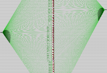

Re: Another RS232 communication
Postby JB_AU » Sat Jun 28, 2014 10:06 am
I am so glad i use 7x64 & have DEP enabled, just too many insane modules would have eaten all my ram.
Like this one ;
Albert Einstein
JB_AU
