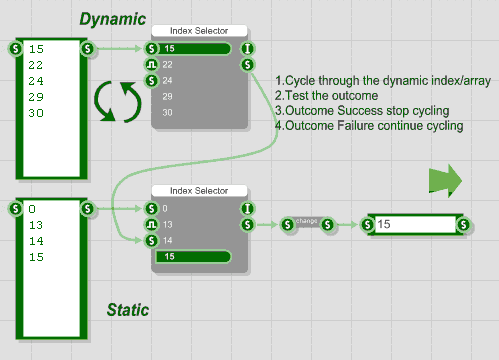

I am overly unkeen to learn ruby, i have good reason not to. Is there a way to make an index or an array cycle through based on a triggered event?
In my picture i have pulled a dynamic array of past & present com ports from registry for a particuar piece of hardware, i need to cycle through the array & test against the static array of available com ports, if there is a match , another module will use this value to test the hardware for acknowledgement or its presence. If the hardware exists stop cycling, if it does not keep cycling, timeout send msg "Check Hardware".
