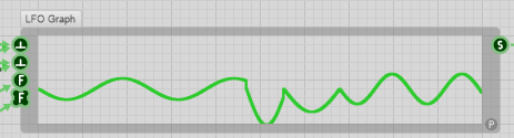

I make an LFO plugin that make random shape, and works on (max) 1280 discrete values, getting a smooth shape. This is a generated 500 values shape:
Once got it, I need to iterate these values; than output (index and the value in my case) at each step:
the output is "smooth" using @lfo_freq value >=0.01, and it doesn't requires too many resources (I'm about 2-3% of CPU).
def startLFO
output "lfo_index_1", @lfo_index
@lfo_index += 1
if @lfo_index == @lfo_length
@lfo_index = 0
output "lfo_value_1", @lfo_shape[@lfo_index]
input 10, nil, time + @lfo_freq
