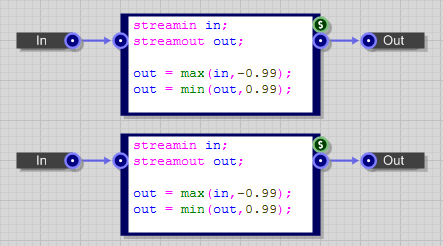

The Dreadful Stereo Clipper
I often see this dreadful stereo clipper module in schematics right before the audio output:
To be sure, it is a good idea to have a clipper there in order to prevent overloading the hardware, which would sound much worse! Of course it is best to stay within the (-1,+1) range in the first place, so the clipper is just a safeguard.
So why do I call it dreadful? Because it is extremely inefficient! Ironically, the design indicates an intention to save CPU by exploiting SIMD for the two min/max operations. However, due to the overhead from the Pack/Unpack modules the savings are more than undone: the dreadful stereo clipper uses 85 cycles on my computer. To put this into perspective, you can build a 4-band parametric EQ with less CPU cost!
Actually you would be much better off with a naive replication of two clippers (15 cycles):
That's not bad, however if you really want to go efficient I'd recommend this optimized stereo clipper (4 cycles):
Here is the code:
Here is the code:

Re: For those not in the no (Tips and Tricks)
Hi Martin,
GREAT post !!
Very informative, my experience has been that the pack-unpack routine usually encompasses a much larger schematic and the 'stereo clip' module is just a safety valve at the end of the schematic, so overall, the clock overhead would only rise by a tiny percentage.
Very informative though, that you show us how clock cycles add up while we're not looking !
It's nice that you offer a mono schematic and an optimized stereo pair.
I would be very interested in learning how you measure clock cycles.
If you have a minute, could you spell it out for us ?
Sure, here is my test kit. Press and hold the black button until the reading stabilizes. You may get different results depending on what other background tasks your PC is busy with while you measure. Also if you stack two modules you won't necessarily get twice the CPU load as you might expect. How much CPU a certain module will eventually use in your schematic depends quite a lot on context.
