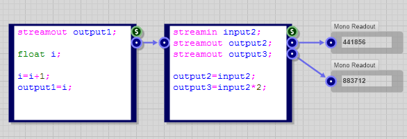

How do you "sync" output/input between DSP codes in FlowStone? For example here:
how can I assure that output2 is always i+1 and output3 (i+1)*2 on every i-sample?
For example, output 3 should run (i+1)*2 before input2 be incremented by 1 on the first (left) DSP module.
Or chaining DSP modules automatically guarantee the order of execution (a sort of ask "backwards" values when processing)?
DSP Stack.fsm
(1.05 KiB) Downloaded 938 times
Thanks for help me, as usual!

In case of streams, correct order of execution is ensured, by how streams are pre-compiled.
It is done from end to start - Flowstone checks the modules connected to some output (most prims with blue inputs, for example soundcard output, various blue to green type of prims, etc.). Then checks which modules are connected to those modules and so on so on and finally puts them together in correct order.
In the example you provided, the right module always gets executed last, because its directly connected to output (mono-readout module) and the left module gets executed second-to-last, because it directly connects to the right module.
Modules which do not have outputs connected to any type of output-prim will not be executed at all.

KG_is_back wrote:In case of streams, correct order of execution is ensured, by how streams are pre-compiled.
I see. Nice, thank you very much. Where did you get these informations? I can't help myself, because I don't find any infos about this, nor in the manual.
