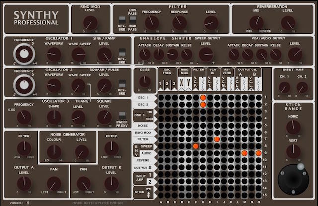

Postby k brown » Mon Aug 22, 2016 9:23 am
That's what I did in the Synthy P - only I cross-faded between a 12dB and 24dB.
Synthy P II copy.jpg (78.18 KiB) Viewed 39901 times
