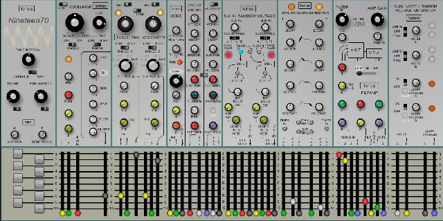

Well, I took another look at my earlier stab at the 2500 switch-matrix patching and was able to relieve enough of the sluggishness to make it not-bothersome (it only affected the outputs, not the inputs); now I kind of like it!
This is a much more complete emulation of the operation and functions of a small 2500. Added the Noise/SloRandom module to System 6, plus the switch-martix patching and a panel of 10 drop-downs standing in for one of the 2500's jack panels. The all drop-down patching has some advantages; the switch-matrix has others. Let me know which you prefer.
tonus Nineteen70 :
tonus Nineteen70_copy.jpg (168.88 KiB) Viewed 34933 times
