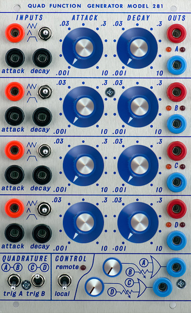

If anyone's still haunting this thread -
Back to the subject of envelopes that can have their times modulated and can be changed while the envelope is looping, I came up with a kludge that does everything required but has a nasty bug.
I built this to emulate as closely as possible the Buchla 281. These ASD (actually ASR) envelopes have three modes (toggle switch on the left):
repeat/(AD loop), transient (A followed immediately by D) and sustained (ASR).
As you can see in the photo, the Attack and Decay times have control inputs (the black banana jacks). There is a pulse (trigger) input (orange banana) for each EG, and each one generates a pulse at the completion of it's Decay stage (red banana). Using this crazy lash-up:
I've been able to achieve all these requirements, however in the specific condition of using one looping envelope to trigger another, there is a nasty random blip/click/thump if the looped triggering EG has a shorter decay time than the EG it's triggering. In the reverse condition, everything's fine. In the version of this envelope type (for my Dodecamodule emulations) that don't need to have modulatable AD times, I used the old ADSR (manual) prim and this problem doesn't occur. But it can't be used for this 281 emulation because only envs with stream inputs can have their times modulated.
My hunch is that the problem probably has something to do with the use of the 'R' module following the AHD - but I've no clue what to do about it.
Have there been any EGs built in the Flowstone era that have stream inputs to the time controls, and have both Gate and Trigger inputs? - I assume that's what's required here (though maybe only needs to have trigger input, since the AHD module used here only has a trigger input).

I hit this issue when making my Quilcom Harvester!
The problem is caused by the AHD. It works in 16 sample increments, so fast re-triggering doesn't work properly.
I've changed one of the AHDs for mine and provided the AHD module at the top level also.
This one is fully evaluated every single sample so it uses a bit more CPU but no nasty clicks!
You can modify any code-based envelope generator this way if you need a fast re-trigger.
Hope this helps!
