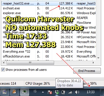

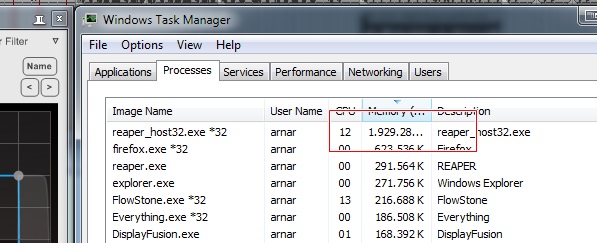

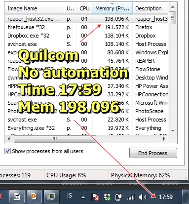

I ran Harvester for 26 minutes.
Quilcom - started .
Quilcom 1.jpg (77.91 KiB) Viewed 35052 times
Quilcom - after 26 minutes.
Quilcom 2.jpg (89.72 KiB) Viewed 35052 times

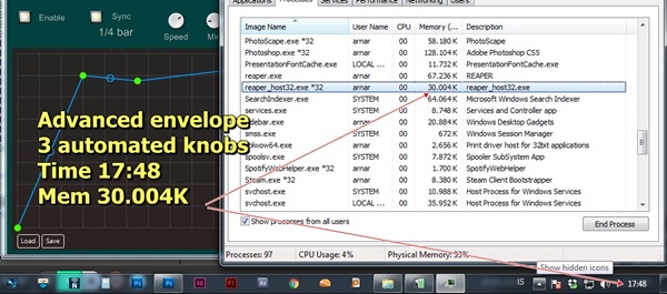

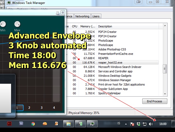

I also ran Advance envelope for 12 minutes
Advanced Envelope-Started.
Advance envelope test first.jpg (75.08 KiB) Viewed 35052 times
Advance envelope after
Advance envelope test 2.jpg (103.08 KiB) Viewed 35052 times
