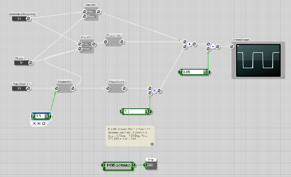

What I meant was when using this saw osc to do PWM by the usual way of mixing two saws, inverting one and shifting it's phase to create various pulse widths, the oscillator goes wildly into distortion when the phase shift is anything but exactly 0.5; so can't produce pulse waves with it - only square.

Thats odd! Pwm should work that way with any saw. Will check later.
Edit: No problem here with PWM. Please post schematic which demonstrates the problem that you are getting.
mv pwm2b.png (33.19 KiB) Viewed 28267 times
mv pwm2.png (35.67 KiB) Viewed 28267 times
mv pwm.png (42.02 KiB) Viewed 28267 times
Is there another way of doing PWM? - these are the only two I know of. How are you doing it?

Sorry your images came out pixelized. Anyway, here is a little demo, hope it helps.

Thanks for that, but I can't open the schematic I only have SM. I tried combining the saws with a stream subtract but get the same thing you see in the images I posted. Is your Phase control just a 0-1 de-zipped knob? And the Multiply module - just an attenuator? Is there anything in those Saw modules other than the code itself?
In general, is there an advantage to doing PWM with a steam subtract rather than mixing the phase-shifted saw through an inverter?

This small modification means the PWM waveform's offset won't change with the pulse width control value. The output is more like an analogue circuit, which passes a ramp through a level comparator.
This modification should reduce modulation breakthrough effects.
