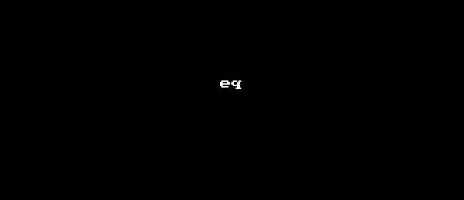

OK, so this is a lot of progress. This EQ is starting to come around. I am hoping to have it complete within 24 hours. The only issue I've come across is the function with automatic view z-index.
It's something that happens when two bells are on top of one another. But, TBH; I haven't really given it much consideration until I have a chance to solve the other problems. I was able to make range something that's built in, and also gain in/out. I'll be adding a pan left and right with similar style of slider, except being on a horizontal plane.
This is a lot of progress. I guess people might wonder why I labour on equalizers so often. Basically I have been buying every one that has been on sale at pluginboutique and I have not been rewarded to any great degree. Though, the soundspot paradox was good in its own way; it's an interesting effect.
Enjoy this preview, and if You can think of a way to solve My z-index issue please post.

The eq curve view does not update for me , also the circle implementation I dont particularly like , unusual and easy to go to another band when you are trying to grab the Q circle. Bit weird , in my opinion, but might just get used to it.
Also unsure if the circle is correlating to the range itself on the graph or if its arbitrary ?
And finally , the bane of FS...Massive cpu from that analyzer...Dividing the redraw by 8 cuts it in half but still.

lalalandsynth wrote:The eq curve view does not update for me , also the circle implementation I dont particularly like , unusual and easy to go to another band when you are trying to grab the Q circle. Bit weird , in my opinion, but might just get used to it.
The curve view? Is that in alpha flowstone or vst?
Hmm, as far as the circle it's designed for touch screen (and it's resonance/q ratio BTW) and also large screens like 4k. Imagine how hard it would be to see that little square. And because the circle opens up only when selected means it can be done with only one fingertip. It was My best solution to solve the touchscreen issue.
I could also add a timed onmouseout event too, come to think of it, so that the other circle does'nt show up right away. So that someone can change their mind.
Right top I've added a menu. it will allow turning off the analyzer.
I've added pan as well. I like the fact that it is nice and wide. Usually pan is so sensitive.
here's the latest (and an image):
