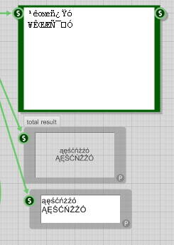

Now, there is one more interesting thing. While language specific (polish) letters are not displayed correctly in string/text primitives (some sort of other strange characters instead) - they are displayed on labels and editboxes. The picture shows the output after encryption/decryption (input and output are match).

It seems to work because you have happened to get lucky that the code key never exactly matched the value of the upper-ascii letter or it would encrypt to char(0) and terminate the string.tester wrote:it seems to work with polish letters
